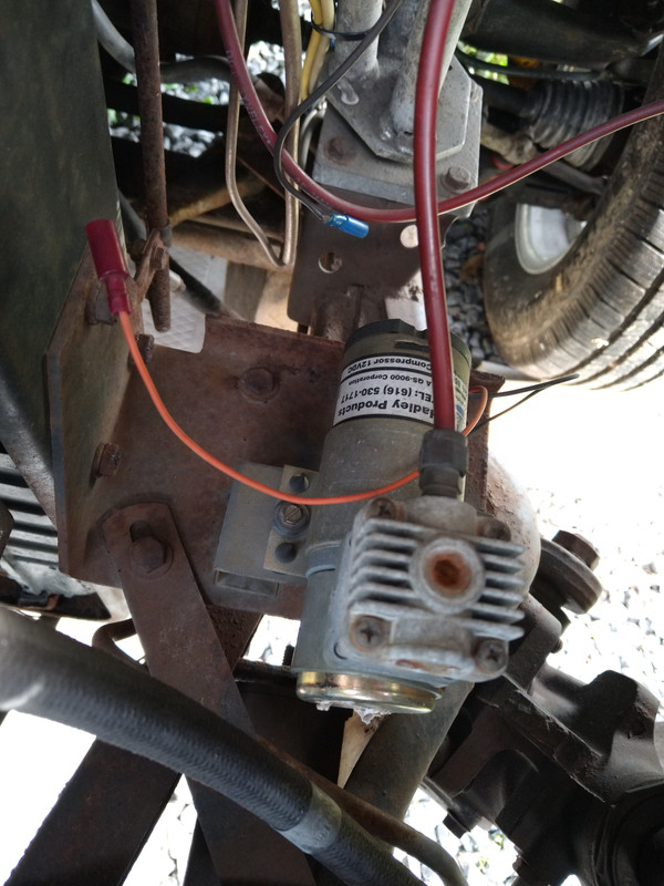

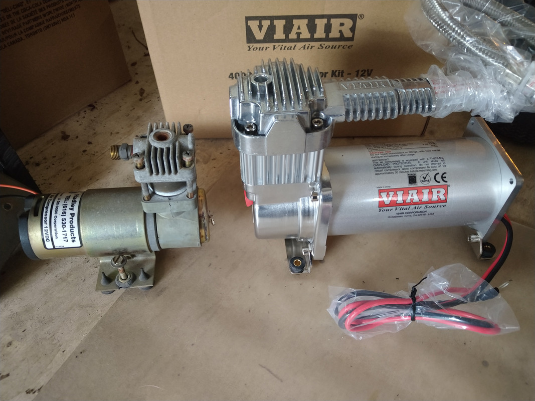

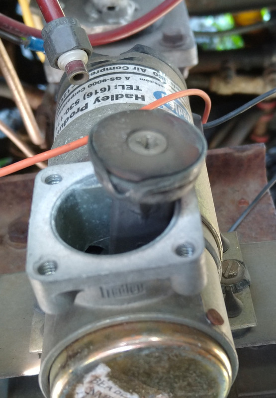

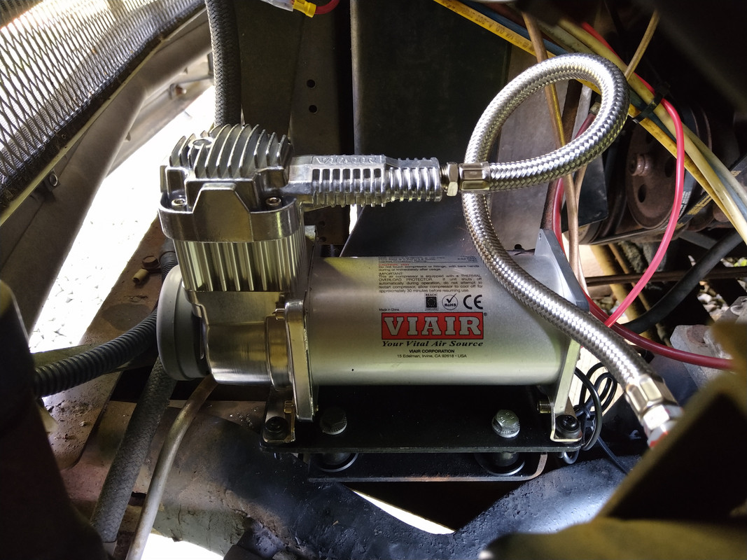

Time for a short update. I found out why the compressor wasn't building any pressure, the piston ring was smeared and busted. I tried contacting the company, Hadley, but no reply and no kits in stock anywhere, so I have a VIAIR on order.

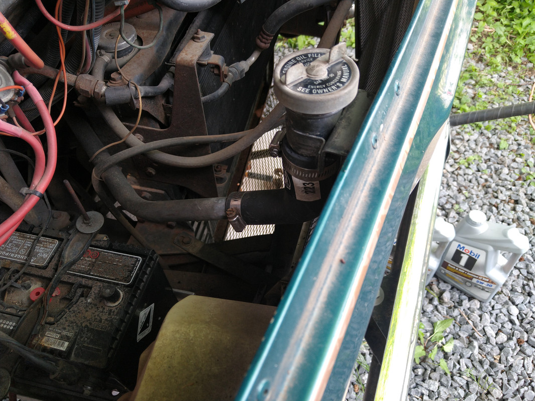

I wanted to change the oil, but found the filler hose was busted. Got a new one.
Filled her with Mobil1 Truck and SUV synthetic oil, should be decent stuff.

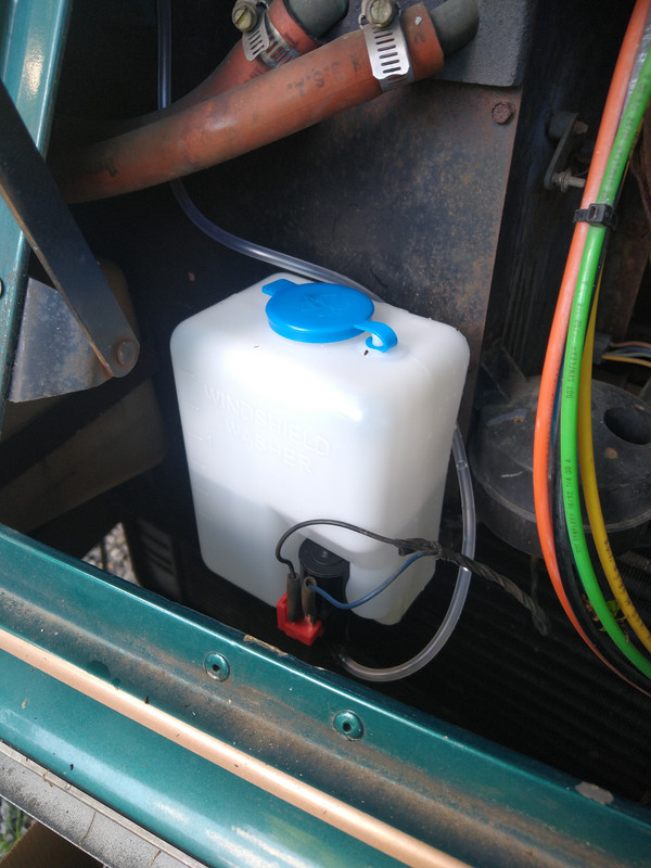

I also installed a new universal windshield washer tank and pump, kinda small, but looks ok. This is the point where I found out the switch is busted and needs to be replaced.

Burl,
I do not believe that it will do any harm. Lube oils today are so very much better than they were not too long (in my terms) ago. Time was that I would never have used a 5W - Anything because of an issue called "Shear Down" that cause lube oils to loose some viscosity with use. From the reports I get from Blackstone I am not seeing evidence of this.
So, if someone says 5W30 is too light for a 455 coach, just smile and say "I'll take my chances".
Burl,
Yeah, I have no qualms about the oil, it's all good stuff. So 5W30 is applicable, I'll keep the 20W50 for air-cooled.
I'll keep an eye on levels if I ever get her out of the backyard, I'm old enough to remember when engines burned oil, it's just a matter of the rate.

I'm definitely upgrading the compressor with this thing.

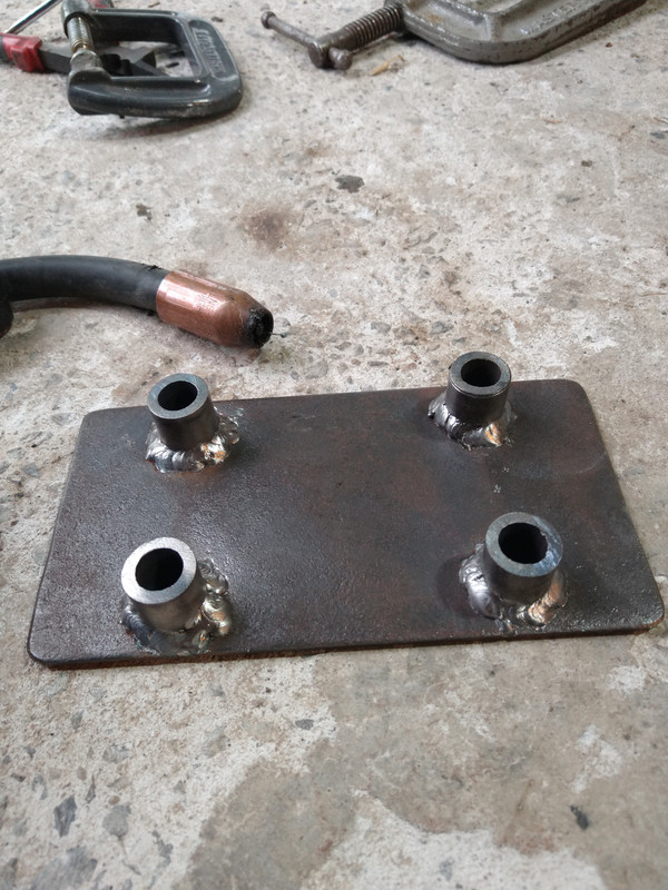

Now I need a new mount, I could just weld on some 1" angle and drill 4 holes, or I could make a bolt-on plate with spacers. Opinions?
Burl,
That should work out just fine.
If it is a 76, the compressor is in the rear. Why not just screw it down to that shelf?
That is what others have done.
Out 73 has the pump in the front. I have a local metal supplier and I am just going to get a 100X400 piece of 3mm aluminum to bolt over the old mount and call that done (once I get the heavier wires in place).

Because nothing is stock on mine, it's up front too. I'll mount it to the same bracket, but it's longer and needs modification, hence either a plate, or welded on angle at either end
I'm making a plate to bolt the new compressor to. I was going to mount it with 5/16" bolts, then realized I have a lack of standard nuts and bolts, everything else I have is metric and I have lots of that.
So, should I keep Roxie standard, or use the 8mm bolts I have in my hand?
Also, should I also put rubber washers under the stand-offs for additional vibration/noise isolation?
That's a predicament for sure. I'm always tempted to use what's on hand and save the trip to the hardware store, but I think I'd make an exception for this. You won't find any metric stuff on my GMC, since I prefer to carry fewer tools. I've got other vehicles with standard engines with metric bodies, and I find it quite annoying to always be forced into carrying both sets of tools. With storage space at a premium, I try to keep the tool set pared down as much as possible.

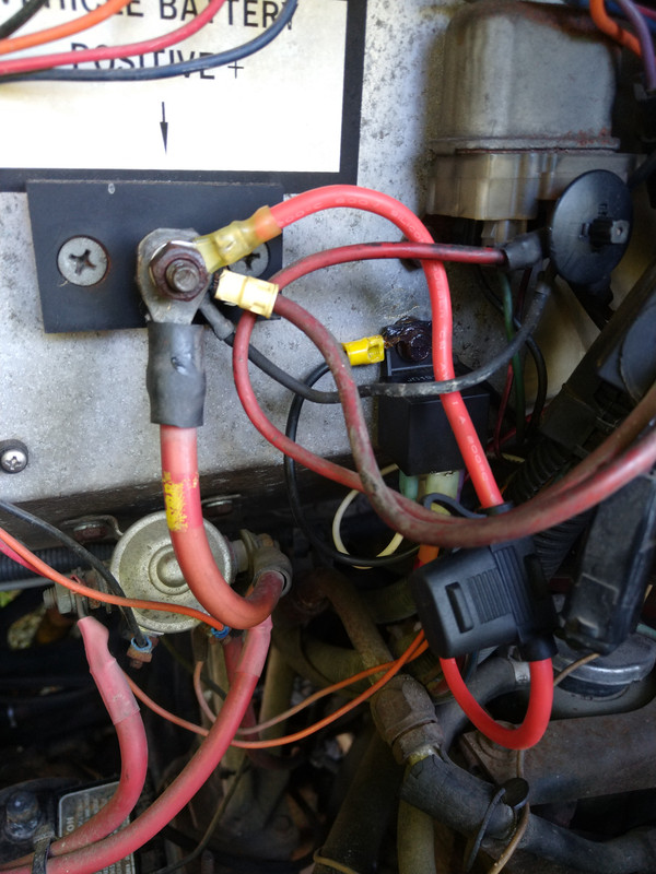

Compressor is in and working. I'll fire up the old beast in a bit and see if the high pressure switch works ok, I have no idea what it's set for.
Fuse and relay on the other side.

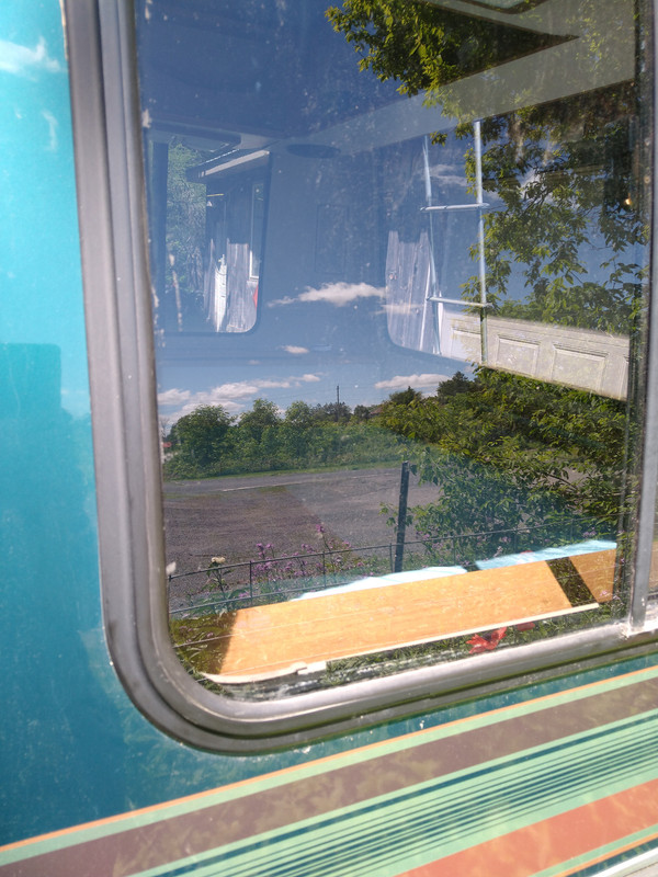

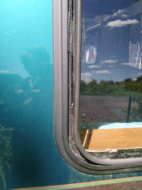

I have put the quest for window rubber on the back burner. Driver's side rear window had migrated rearward and the rubber was out and there was a large gap.
So, after letting it sit in the sun all morning, I took a soft-faced hammer and a piece of wood and whapped it back into place . Looks ok now, I'll tackle the rubber shrinkage problem later, priorities.

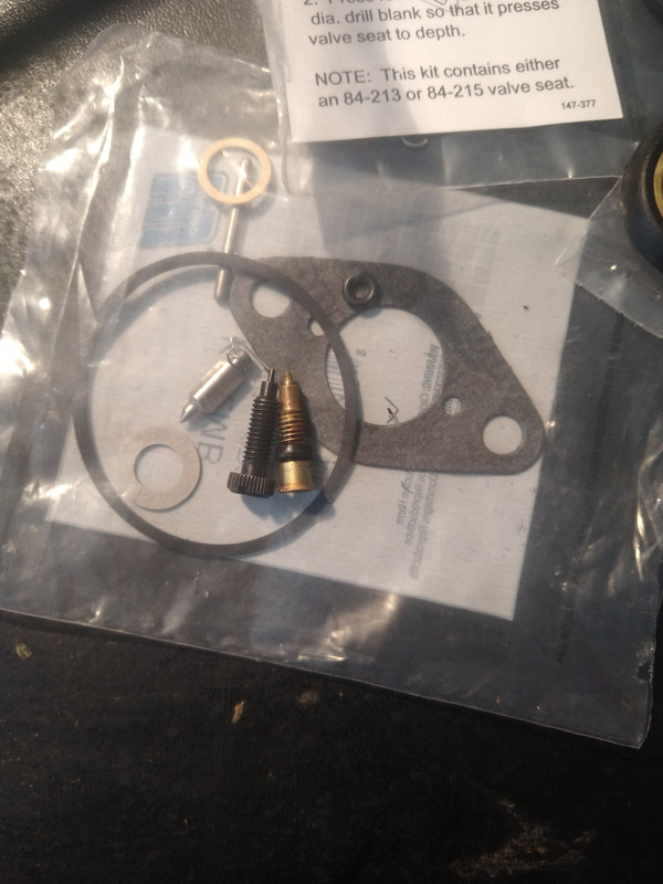

Original Onan needle is on the right, new one doesn't even fit in the hole. Kit cost me $37USD and probably the same amount to get here. Should have just bought the gasket I needed.
So do I have an oddball carb...or is it the wrong kit?
It says K1-LMB on the bag.
I'd open up the gap again, squirt in some good quality polyurethane and knock it back in place. Then forget it. Fixed.

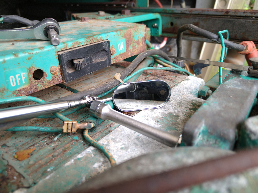

I installed the carb on the Onan and tried to get it started, that's when I found out there was no spark. Traced it to points that were never set up correctly, it could never have ran as the points never closed. Adjusted by mirror, filed a little, now I had spark.
Couldn't even get a sputter out of it until I held the choke off and took off the air filter hose. Then the occasional sputter, got better, but died as soon as I let go the starter switch. Finally I hot wired +12 to the coil and it stayed running, not perfect, but running ok.
So I guess a relay isn't pulling in, or making contact, or something similar, will check tomorrow. Glad it runs though.

Burl,
This is why most of use have installed a flywheel triggered Pertronix. If you do, set up an extra 2° because the push rod set was soo bad that Onan had to retard that far just to be safe.

Burl,

That still won't give any spark control, it's fixed at something terrible like 15* . This is why there's so much unburned gas in the exhaust on these genny's, at rallies it's been described as unbearably fumey in the campground when there are several GMCs running their generators all at once.
Todd,
There is apparently something you don't know about engine controls.
Constant speed engines like generators do not need any advance curve at all. Even with the varying loads, there is no requirement for changing the ignition timing.
And yes, the guy we had in from Onan told us that the push rod ignition was so unstable that durability required that they retard the timing about 2° from MBT to stay safe. So, if you are going to flywheel trigger, you can put that 2° back in and the unit will run better for it.
