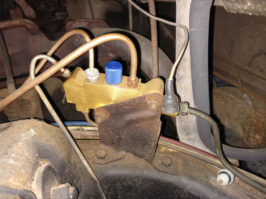

I did notice that my MC needed bench bled A LOT. I pumped until I was blue in the face, and the bubbles stopped. Then, I loosened the vise, changed the tilt angle of the MC, and pumped some more...MORE BUBBLES. Ugh. It was a finicky one. I think I bled it in the nose-up, nose-down, and nose-up positions before I was satisfied the bubbles wouldn't return. Then there's the matter of the combination valve, and using mirrors/lights/borescopes to ensure it was in just the right position.
I went to 15-20 psi on my power bleed with the Palm Beach. It was a vastly superior experience to the lazy bleeding that occurred a couple years ago with my Glenbrook using the vacuum bleeder. The fluid moved with motivation, and the transition from dirty/aerated to clean/consistent fluid was sudden, distinct and final. Pedal felt pretty good, though I've got a bit too much take-up at the rear shoes still. The second pump is very firm once the shoes settle in to place. I'll have to adjust those.
Yeah, I couldn't believe how much air was in the MC, I think I got it all out bench bleeding, but it took a lot of pumping.
I had to remove the switch and manually re-center the combination valve, then I installed my little device to keep it centered and bled some more air out, only got air from the rears, fronts seem fine. Pedal is finally firming up some.

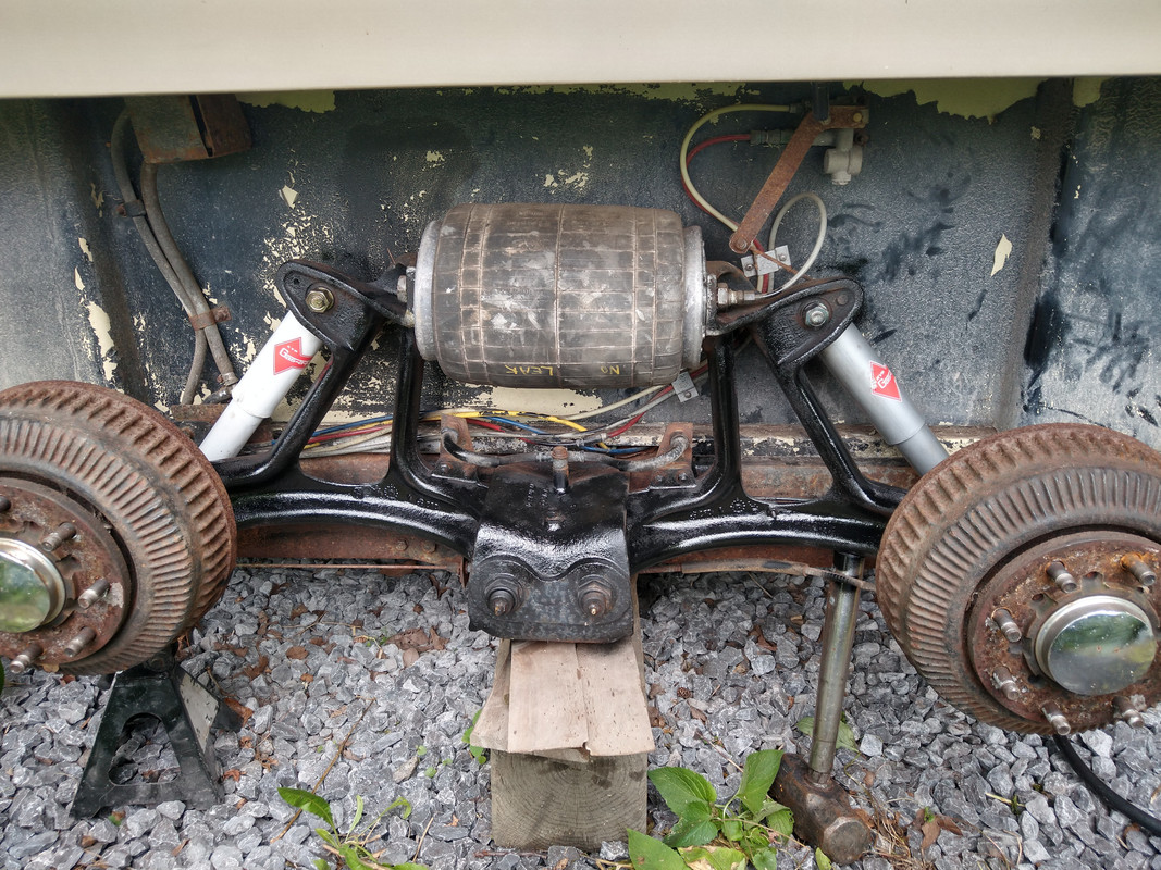

While I was at the rear bleeding the drums I couldn't help but notice I need shocks on one side, passenger has two KYBs that look ok, but driver's side looks kinda bad.
Oddly, I have one new in box rear KYB KG5436 that came with the spare parts when I bought Roxie, so I only have to order one more at least

New shocks are on. Old stock is white, new is gray. Found a fluid leak at the fitting for the brake on the left, hopefully that's the last leak and the pedal will stay hard now.

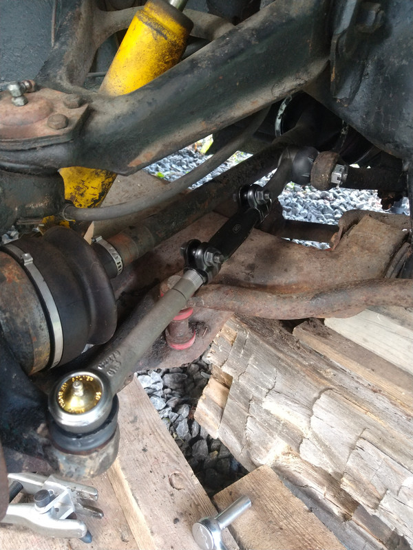

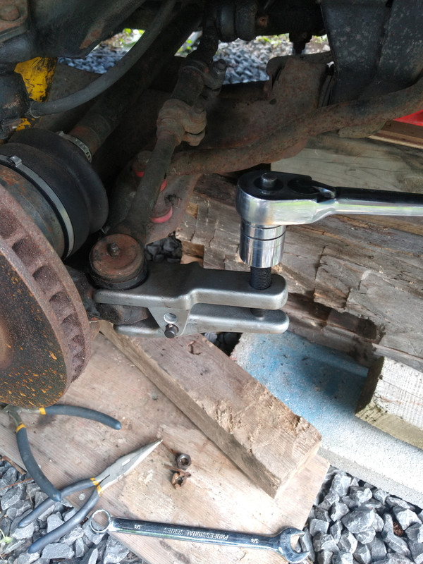

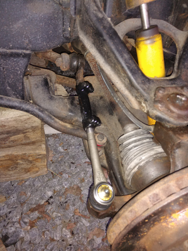

Sooooo, most of the inspection was great, but Roxie needs tie-rods, inner and outer on passenger side, outer on driver's and also the one at the drag link.

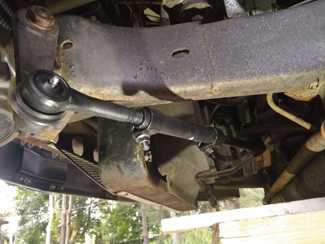

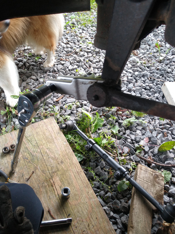

I already received the outer tie rods, ordered the drag link from Dave Lenzi and the inner tie-rod and sleeves from Applied. Threw in a jacking adapter onto the order as I have no jacking devices.
Will see how long it takes for parts to get here.

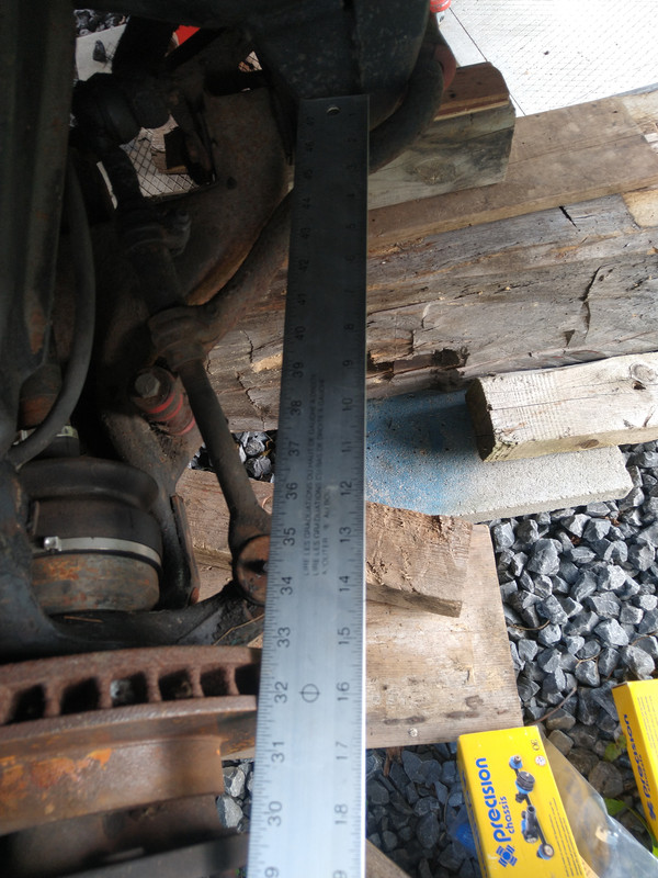

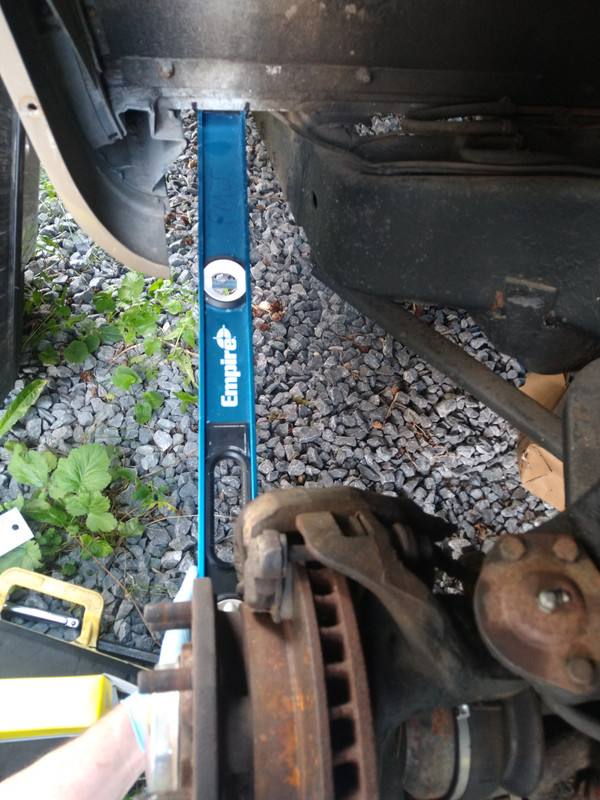

Had to make sure the tie rod assembly was the same length as the one I took off, so used a straightedge on the rotor and marked the framework.
Took some measurements in the other direction to double check things.
Got to use my rarely needed tool.
New stuff is in. Now to do the other side, just the outer there.

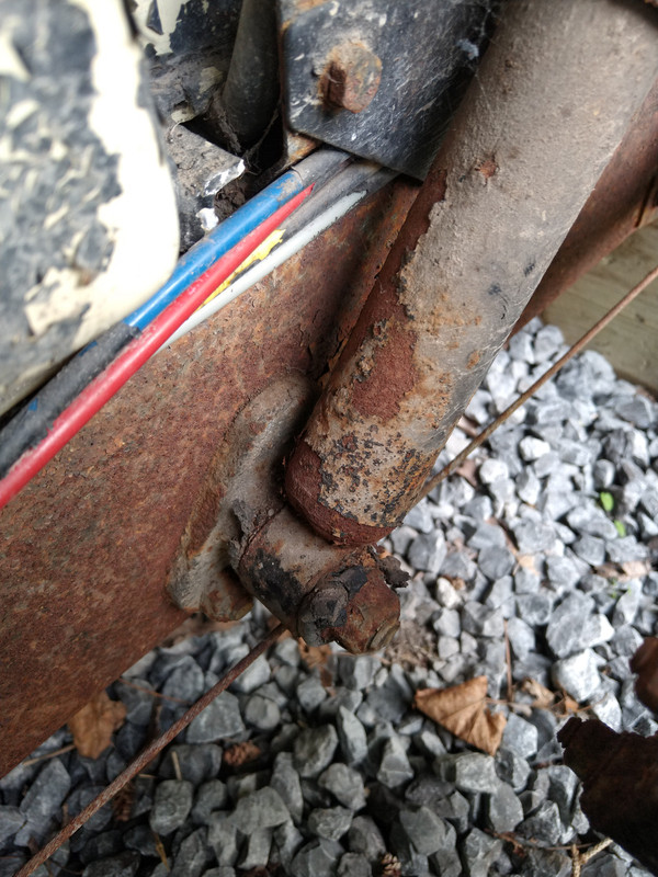

Got the rear lights working, looks like a connection right at the light switch needed wiggling, I measured voltage there and now they work.
