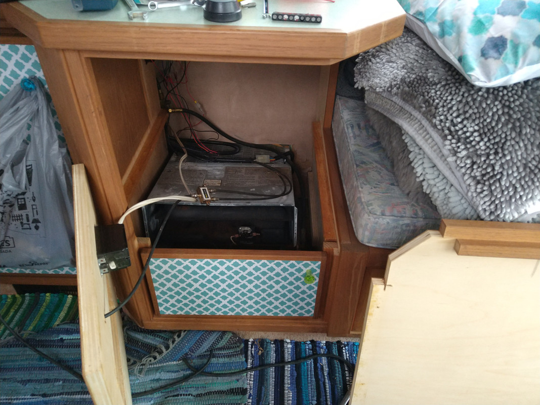

A minor update. I found out the propane tank isn't empty as I was told. I also took a closer look and it really isn't in bad shape rust-wise. So for now I'll use it. I also added a new stay-longer fitting and hose.
That brings me to the next thing, I couldn't get the furnace to fire up, the fan runs, but that's all.
So I started taking it out, got to here and decided to check the temperature limit switch, it was reading 1.9M-ohm, with some fiddling and contact cleaner I got it to 90k-ohms. So, one is one order, hopefully that's all that's wrong.
