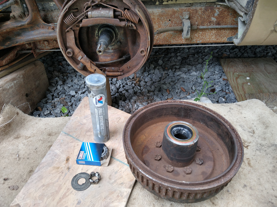

So, I'm trying to figure out the brakes, or lack thereof, when I found this:

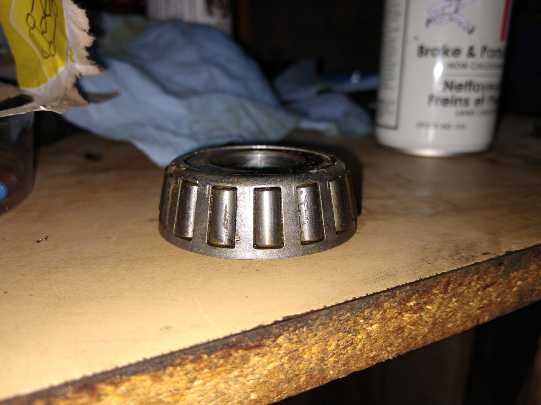

So I guess I need a wheel bearing. Will check the other side too. Good news, so far the brakes back there look fine..
  • Wow

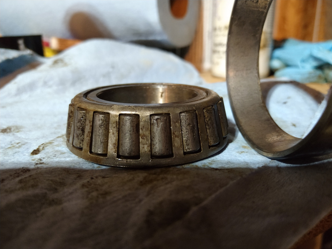

Inner bearing was pretty pooched, outer one wasn't far behind. The dust cap had a hole in it, water must have gotten in. So, I picked up most of the parts this morning, waiting for a race and a seal which should be here Tuesday.
Good job finding it at home, rather than on the road. I bet that's a relief! Now I feel like jacking mine up and giving all the wheels a good spin again.
Be aware that the rear axle seals available now must be left slightly proud of the hub so they don't touch the bearing. Also proper torquing of the axle nut is important for proper pre-load.

Of course I read this now...
I just wasted a seal. I pressed it in flush, then noticed the seal lip nearest to the bearing was actually touching the bearing. Didn't seem right, so I pulled it back out, and now here I am. :unsure: I guess I'll give it another go.

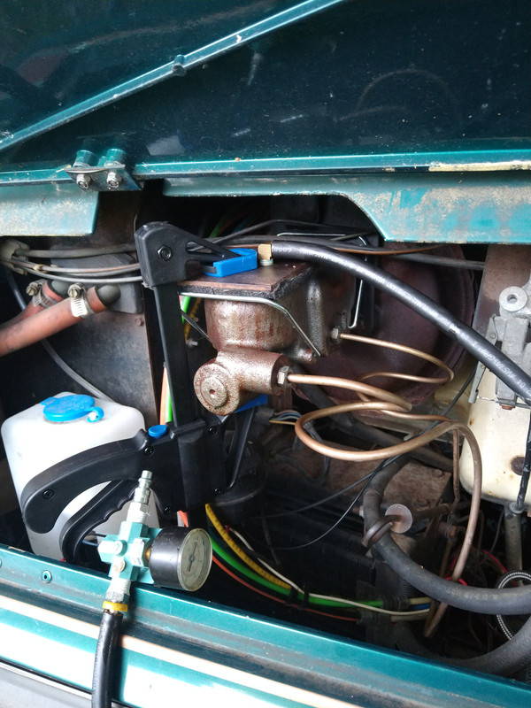

I installed a PVMH distribution valve and tried to bleed it. I finally gave up on the master cylinder it came with, which is supposedly new, but of course probably Chinese made junk. So I recently bought another Chinese MC, I went to 6 parts shops in town and ended up with a Pronto master cylinder.
I bench bled it, installed it, tried vacuum bleeding it and that wasn't working well, so I made a quick and dirty pressure bleeder cap and it seemed to work quite well, got lots of air out of the rears. Will try the fronts tomorrow.
Now though, my PVMH distribution valve has tripped, spool shifted, I do have the insert to hold it centered if I want to bleed it more with the pedal, but what's the best way to get it back centered? A mechanic friend said kicking the brake pedal often works, otherwise I guess I'll have to remove the switch and try to poke it back into place?

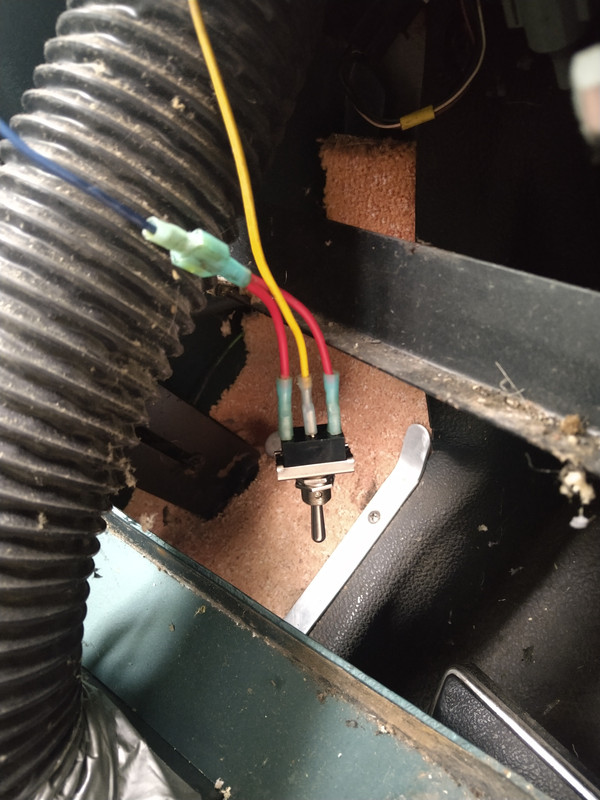

Also worked on the wiper washers, earlier I installed a new tank and pump, but the electric switch was busted so couldn't really try it. Anyhow, Installed a new toggle switch and wired it so that up or down works.

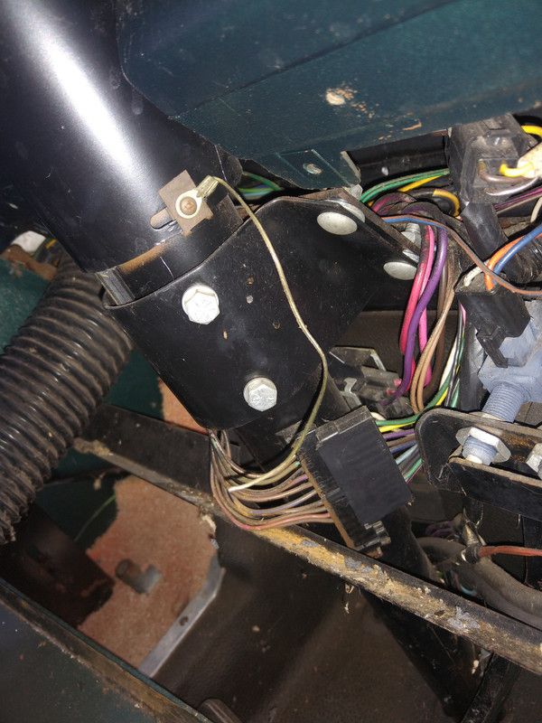

While I was in there though, I found this small broken wire on the steering column....any idea what it's for?
