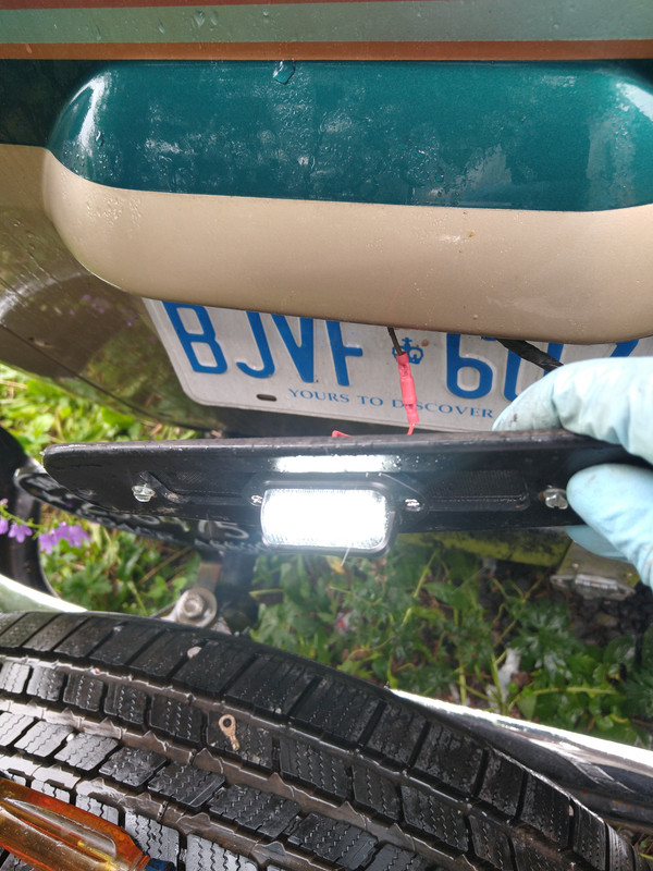

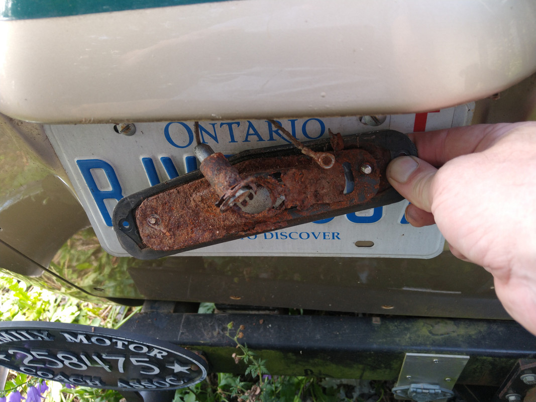

Noticed the licence plate light wasn't working....found out why. There was a mouse nest above it, thankfully they didn't chew the wires. LED kit going in when it arrives.
LED licence light I put together. Used a piece of vinyl flooring sample to fill in the hole and mount the light to the original fixture.

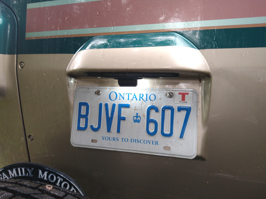

Safety is done, now for some paperwork and she's legal for the road
Looks great!
Now what is that "T" sticker on the licence plate about? I pulled the stack of stickers off my plates since we no longer have renewal stickers.
Looks great!
We still had Ontario stickers when I bought Roxie and drove her home. When you buy a vehicle that doesn't have a valid safety you can get a T temporary sticker at MTO when you change registration and pay taxes, it's only good for 10 days, which is usually enough time to get something safetied.
You must not buy too many questionable vehicles and try to get them home, I've done it a few times over the years, Roxie is just the latest.
Ok, I understand now. When I bought the Murray, the previous owner took it to Borrmann's and had it safetied as part of the deal. So when I picked her up, I had the Safety certificate. My other vehicles have all been new.
