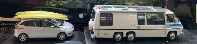

My coach finally arrived from Cliff Golby late Wednesday night and I was finally able to get this setup together for the first time. I had the (2) YMGI Mini-splits, custom ac mounting frame, wheel cover and Thule box painted to match the coach. The Thule is not yet quire leveled. There is a through the bumper hitch which is supposed to have a 15,000 lb rating. This setup reduces it to 7,500 lb. When I tow the toad, the Thule is moved to the rear of the toad. The Thule is rated for 350 lb. View attachment 14545
Note that there is nothing on the roof. The storage box and the heat pumps are completely out of the air steam.
The normal lpg compartment does not have a tank. There is an additional compartment behind the front wheel for the lpg tank freeing the old compartment for storage.
I am now ready for the solar panel installation.
View attachment 14547View attachment 14548
License plate not on the Thule yet. I've got to fashion a plate to cover the "Thule" and put the GMC logo on it.
The spare tire is made by Roadmaster. The vertical mount post actually telescopes to provide leverage to swing the tire to the ground on either side.
Remove the cover and rotate the tire to the ground. Unbolt the tire and roll it to where it will replace the flat tire. roll the flat tire to the mount and bolt it. Then rotate the mount to the vertical position.
No tire lifting!
There is plenty of free air for the heat pumps. The storage box can rotate backwards about 30° to provide more access to the tire.
It can hold 350 lb. Looks a bit like a Pacman.
I have got to shorten the GMC Motorhome's base to get the C-Max toad down for accuracy, but I think that is is very cool to RV this way.
Don.
I think that there will be very little air resistance, but I am thinking about a rear spoiler on the coach. I have seen a few applications.
I have 2 red 16ft Hobie kayaks using Thule Hullavator mounts that support and drop the kayaks on the side of the vehicle.
