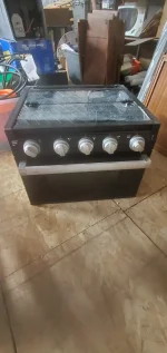

I like your cooktop idea! I don't think we've ever used 3+ burners at once. More counter space sure looks nice.
Yeah, we bought a New Furrion stove/oven at auction in town and the more we thought about it we said are we ever going to need three burners and the oven? Nope. Oven is still available if anybody is interested I will make you a deal. Just like a lot of other things we picked up for our coach and are NOT going to use. :(
