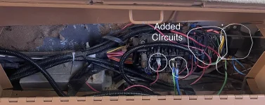

I have been trying to work my way through the wiring in the coach and then implementing my new electrical design.
I downloaded the original GMC Electrical Plans and then decided to print it out. It took about 9 separate pdf's to print out (9) 8 1/2"x11" sheets to bind them all together, end to end. I had the total print out, black and white, which is now rolled up around an old cardboard roll from a paper towel. At lest I can roll out the entire drawing to see what is what.
However, I am still pulling out old unused wire to get rid of the rat's nest of ancient wire.
The new electrical system bears little resemblance to the original wiring. I decided to start from scratch to put together a plan that will allow anyone to track down things in the new arrangement. Instead of using a black and white drawing with electrical symbols for components, I decided to try to use photos of the components connected with colored lines of various thickness to make it easier to find myself around the diagram. I think it will help the people I may hire to work on the couch for me or future owners.

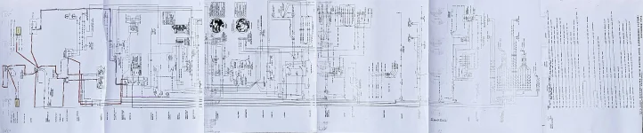

In order to actually find out what the original factory wiring was like, I printed out the original wiring diagram on (6) 8.5"x11" sheets and pasted them together.
Sorry about the semi circular smudges!
This is the base line and this layout doest no include some of the factory options.
At least it is a start.
I started to color the wires so that I could understand it better, but I just got too tired to finish it.
In order to get my final diagram, I I need to ring out all of the wires now in the coach.
They include the original wiring, wiring by previous owners, wiring done by Cliff and of course by by Jacob and me.
I hope that this image will help you.
It may be the first time you have seen this all in one piece. This is 11" wide & 51" long.

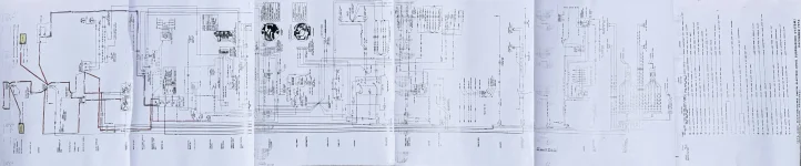

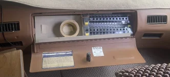

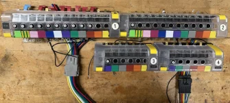

Rather than stuff (4) of these to get (48) 12vdc breakers, I decided to add (2) 6 breaker panels for a total of 36 breakers.
Notice the trimmed ends.
