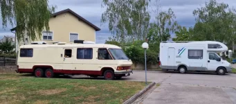

Well, our Revcon is finally on the streets again. Thanks to the Forum community! On Thursday we will leave Lower Austria...
On the right hand side you can see the typical European Camper size and this is considered to be "large".

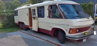

I wanted to get the new foil trim done before winter time in the first place, but the car wrapping company was too busy. :rolleyes:
I found a photo of a 1979 Revcon, which is going to be the template. The style of my Revcon was just the same as this one.
But I want a smaller foil cut, because I think that this will look more elegant. The color should be dark red, like the one we used for the bottom side of the Revcon. The position of the lettering is going to be the same.
The "arrows" should be smaller too and I don´t want to have them pasted over the generator flap.
Now the deadline for wrapping my Revcon is April/Mai 2023. They need warm weather to get the job done. :cautious:
