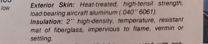

I have bought two original sales brochures from Ebay.
They provide some very interesting information, e.g. the use of aircraft aluminum (6061) for the exterior skin.

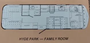

I like the floorplan with the big bar option opposite the kitchen. Could the GMC Motorhome be ordered with such a feature?
Well, in those days everybody needed a drink everywhere. Have a look at "DALLAS" (1978).
This show was heavily played in Europe. Obviously an expensive motorhome from the 1970ies had to be delivered with a kind of booze storage. There is also a small second bar between the swivel seats opposite the sofa. My Revcon is equipped with a kind of mini-bar, including a mirror and a brattice above the fridge.
Later models didn' t have the big bar option anymore. I like the "family room" in the back.

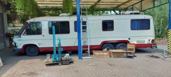

The second AC is already on the top, but my mechanik hasn´t installed it yet. New shiny red color on the lower sides of the Revcon.

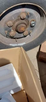

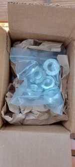

Finally, I have found some wheel nuts that really fit. A member of the German Astro/Safari Van Forum sent me the link.
One nut broke during the wheel balancing procedure last year. The mechanic was not aware of the left-hand thread on the driver´s side.

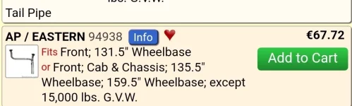

Exhaust manifold gasket change. The manifold came off easily, but the edge of the pipe broke.
The worn sealing is not the problem, I can order it from Rockauto...
...but where can I get a new pipe from?
Should be willing to ship to Germany.
It's a shame the edge of that collector pipe went bad. I've never had that happen. Do they salt the roads in Austria? I'm in a salt-free state, so I don't see a lot of the rust related failures other people struggle with.
