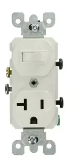

I had to change the socket for the "buzz-box" to a 20A type (with switch for the water heater). The converter draws 12.5A at maximum usage, so the 20A circuit breaker (combined converter and water heater [not in use]) is just fine. Luckily, all of the AC wiring in the coach should be 12ga (which is required for 20A circuits) and it's all short runs from the 50A junction to the breaker box/water-heater switch.
All items have been procured and I have successfully run for a weekend (just fridge and freezer) from the battery with no panel attached. So, adding solar charging to the mix should provide adequate boondocking time.

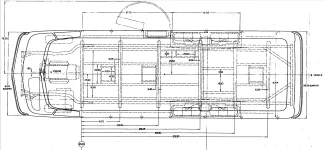

Anyone have a good dimensional drawing of the roof of a 26ft? I found this on GMCMI.
If I did the math correctly, there should be 21.35" between the front cap seam and the front fan opening, 30.05" between the front fan opening and the front A/C opening, and 102.25" from the A/C opening to the rear fan or A/C opening. I'm trying to find the surface width of the roof from drip-rail to drip-rail (91.84"? 85.5"?).
The Gree A/C unit has the dimensions below (flip it to align it properly to the roof drawing). This should result in a space of 78.25" between the rear of the housing and the leading edge of the rear fan opening.
I hope to place flexible solar panels on the roof, following the curve of the roof. The panels have the following dimensions (both sizes have the same electrical ratings):
Short 42.5" x 26"
Long 82.2" x 13.7"
It looks like I can place one short and two long in a "horseshoe" shape in front of the A/C unit. Then, I just have to determine how much space I have to maneuver around the vent pipes between the rear of the A/C and the rear fan (3 short + 2 long?).
This all assumes I have at least 83" of width on the roof.

Apparently I have 81.4"
