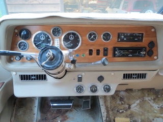

This thing is nearly complete! The bezel around the tell tales (box in the middle) is still unattached. That will need a little finesse still. I need to trim the bezels around the gages as well, since cutting perfect circles in engine turned aluminum foil is VERY tough. I had done it before, but peeled it off when I started building this bezel. Obviously, I still need to wrap the dash padding in upholstery as well. But...this still feels like a milestone.
Some close ups (where you can see boo-boos in the applique). I also have new lenses for the gages. Was using the old ones so I didn't scratch the new ones. That is why the fuel and voltage gages look so "dim"

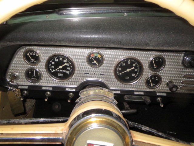

My 56' Studebaker Golden Hawk has a dash like yours. Inspiration for my GMCMH dash came from it. Just FWIW.

If you wanted to clean up the lines (circles?) around the gauges, I think a 3D printed black bezel could snap into the gauge and have a flange the goes onto the face of the bezel. It doesn't look like those gauges had much of a flange, so adding on with a bigger flange could make the setup a little more forgiving. If it's printed in ABS it could even be vapor smoothed so it doesn't look printed at all.
My '55 Roadmaster has a wrap-around engine turned dash that goes all the way down the door panels too. Such a great look for a factory vehicle. It really boosted my affinity for engine turned dashes.
Paul, the bezels there are ABS and I did print them. I planned on doing exactly as you suggest, printing a thin, small trim piece to cover up the poor cuts.
Oh, I had to zoom in further! I thought those were just part of your gauges. They look good! Just needs a bigger lip.
As my dad always told me, "Trim and paint will cover a multitude of sins"
I do like that combo of the engine turned applique and the black bezels. Looks sharp, great contrast. It's somehow simultaneously modern and retro, at least in my mind. That product has a great appearance on camera too--does it look that good in person? It seems like it really catches the light and has good depth; I've seen a lot of them that look more subdued. What brand is it?
