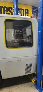

Yes, in the early 73 coaches that were all built with electric refrigeration only, there were no exterior vents. All the vents for the reefer were to inside around the reefer cabinet.
Problem 1: i When there were complaints in hot climates, the dealers cut in both roof and side vents.
Problem 2: Roof and side vents were added. Remember the existing vents to the interior? Those still existed and allowed the outside air (now ~20°F) to flow into the interior.
I closed off the vents to the exterior. I added so computer fans to move the hot air out the reefer box, and they are on a theral switch and they never run. Be aware that residential reefers use the case side as condenser so there has to be room to move cooling air through there.
