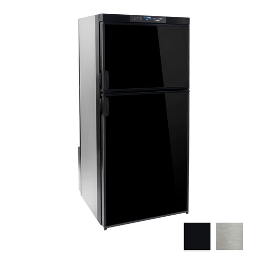

Here is my leading contender for an absorption 3-way refrigerator
A beautiful appliance, three-way power

Yeah, the NA7XLR is a electric/gas absorption refrigerator
The Norcold N8DCBKR is strictly 12vdc compressor refrigerator
less hardware, no venting
