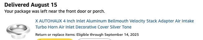

I am still working to optimize the air ram. The old photo showed the 2 1/2" funnel opening but moving the 4" deck ring to the inside of the funnel instead of being outside with be a better design.
These photos show what a gapping maw this inlet is.
