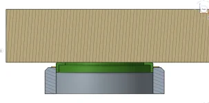

So, something like this, if you have the right size of wire, and don't want to make a tool:
Then just press down until the press block bottoms out on the wire. There would be about another 1/8" to go in this pic below.
I abstracted a lot of the detail out of the seal obviously, but the main problem is an inner lip they tend to have these days, circled in red (and exaggerated). That lip didn't used to be there, and you could press seals all the way flush with the hub. Somewhere along the way the lip showed up in parts, and someone discovered it can rub the bearing cage and make metal dust! So we just don't press the seals all the way in anymore.

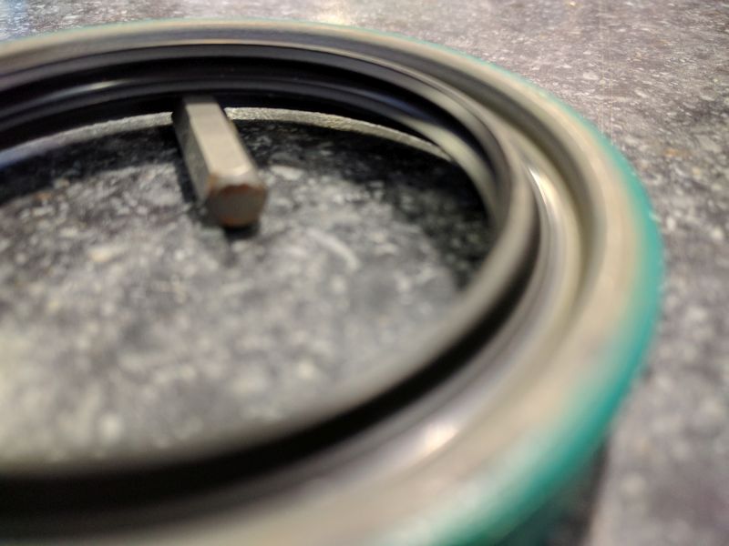

This is what seal/bearing interference looks like.

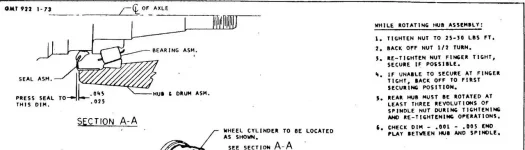

That's why we adhere to this:
