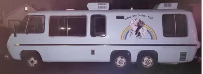

If anyone knows the history, it's the blue "Mr. T on a Unicorn under a Rainbow" vehicle. I have another co-worker familiar with the Olds 455 engine (former hot-rodder), so I may have a local support "group" (the previous owner once-removed of this vehicle has two others; his wife told him to lose one...). My co-worker had it for only 6 months, planning to turn it into an Air BnB (never going to drive it). His plans changed.

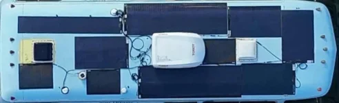

Down the road, I intend to move to a lithium-based electrical system using a second alternator supplemented by solar panels (I've been using solar and lithium for my camping setup for some years; refrigerator, freezer, ice-maker, microwave oven, ceiling fans... in a tent...).
UPDATE!
- 900W BougeRV Yuma CIGS and 165W flexible mono solar panels installed (1065W total)
- 560AH lithium battery installed
- 4KW Pure Sine Inverter installed
- Rooftop heat-pump running from batteries!

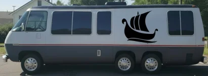

Probably re-paint (dove gray top, charcoal bottom) and new art....
View attachment 10286View attachment 10290View attachment 17145
(AI assisted image creation)
