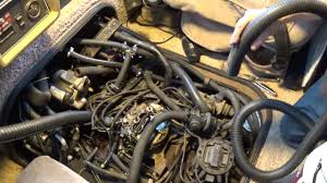

Guys,
Last year I got a kink in my upper radiator hose which resulted in engine damage. In the quest to buy a spring for the upper hose, I came across this in AI. I thought it may be helpful to others. For me the spring is cheap insurance it doesn't happen again.
AI Overview
For a classic GMC Motorhome (1973–1978 with the Oldsmobile 455 or 403 engine), the upper radiator hose requires an internal coil spring or a heavy duty, thick-walled construction to prevent it from kinking, flattening, or collapsing during operation. [1, 2]
Because the upper hose travels a tight path beneath the front firewall and engine hatch, it is highly prone to hidden kinks that cause catastrophic engine overheating if not properly supported. [1, 2]
The Problem With Modern Hoses
Sourcing and Parts Solutions
Installation Tip
When transferring or adding a spring into a new upper hose, spray silicone lubricant or soapy water inside the hose first. Temporarily straighten the rubber bends and twist the spring in a corkscrew motion as you push it through the tight bends. Trim your molded hose ends carefully so it matches the factory length exactly and won't buckle under the engine cover. [1, 2, 3, 4, 5, 6]
If you are currently replacing your hoses, let me know if you need the exact NAPA part cross-references or if you are also changing out the thermostat at the same time. [1]
