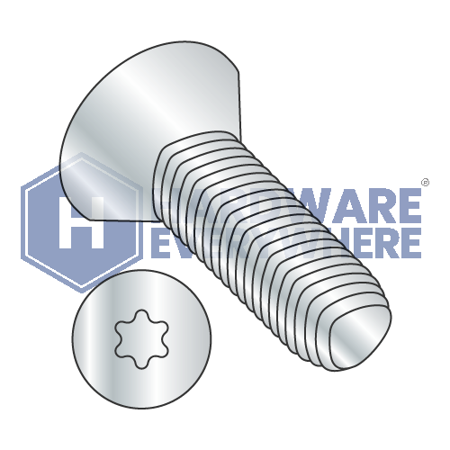

Not having much luck searching for readily available screws in small quantities. These are the screws (but it's doubtful you'd want 40 pounds of them).
Not sure why McMaster doesn't seem to carry them anymore. 🤷🏻‍♂️

McMaster Part Number no longer works. Here's the right type of screw but the wrong size on Amazon.
I've searched until I'm blue. Very odd to only find places that sell in 500/1000 piece lots, or don't have the usual drop down dialog to select screw sizes. Maybe you'll have better luck.
