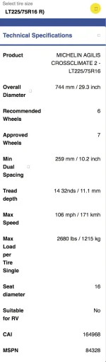

In the "Suitable for RV" section it says....No. 🤔
Higher up on the same page it lists vehicle types including RV. The issue may be that that size comes in both 115 (2,680 lb) and 121 (3,195 lb) load ratings. The pulldown doesn't show the 121 load rating as an option. On the other hand, load rating 115 would be okay for our coaches where each front wheel supports 2,000-2,250 lbs (rears typically less).
See https://www.tirerack.com/tires/Tire...&rearRatio=45&rearDiameter=18&performance=ALL
Our LT225/75R16 Load Range E 10 ply tires typically max out at 2680 pounds. That must be a DOT or tire manufacturer standard as it holds for most all of the tire manufacturers and tires I've seen.
Not sure why Michelin would show that tire as not being suitable for an RV. 🤷🏻‍♂️ Anyhoo, probably a mistake but worth a call to Michelin tech support if you're looking to buy those tires.
