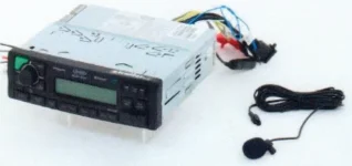

This monitor will be mounted on top of the dashboard to the left of the steering wheel. This only has lidar sensors and is not attached to any cameras.

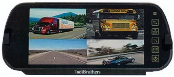

I have (2) of these monitors located on the top of the dashboard. I will probably only use 1 or at the most two images on these monitors. You can see them on one of the most recent photos of the cockpit area. They are designed to snip on to a standard rear view mirror, but we made a custom bracket to mount them on the dashboard.
I like their shape as they seem to be compatible with the shape of the original dashboard.

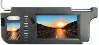

These visors come in driver and passenger versions. I bought both. As you can see in the cockpit photograph, when joined together on the driver's side, they are about as long as the standard visor.

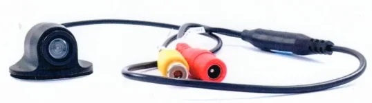

A front facing tiny camera in front of the passenger seat on top of the dashboard at the bottom of the windshield, facing forward.

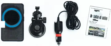

As for determining which image will be on witch screen, that will have to be determined after all the systems have been installed and tested. At least the systems are flexible enough that it can be adjusted over time to get the best combination.
