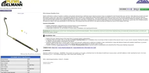

One of my to-do list items was to replace my power steering high pressure line. No leaks but it was pretty crusty ! I didn't want to have to try to repair this on the side of the road.
Here is the rubber portion removed from the coach.
A new hose from a similar year Chevy C-30 got me the pump end bend and flexible section needed. It was a Edelmann 70911E Elite Extreme Weather (whatever that's good for?) and was $16 from RockAuto, a little more money than the standard one. I think the standard replacement hose was about $10.
I cut it off and flared the line. I even remembered to put a tubing nut on before flaring!
BTW I highly recommend getting a Mastercool hydraulic flare kit. It makes flaring steel or Copper Nickel lines so much easier.
Then cut off and flared the old steel line, bending it toward the pump after the mounting tab on the frame and joined with a union:
Should be good for a few years again. Hopefully no leaks!
