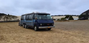

The coach pulled the toad reasonably well. We're a little slow on grades, down to around 35. I'm having serious thoughts about 3.70 gears with an LSD, but we might need the jaws of life to pry my wallet open that far.
We toured quite a few places from Reedsport, to Coos Bay, to Florence. She doesn't look half bad if you stand back a ways.
