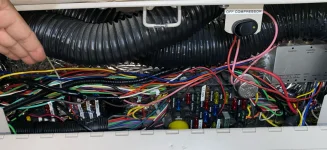

Was wondering what anyone is doing on the dash wiring? I know its 50 years old now. Is there concerns on it? Do you guys go to a new wiring harness?

If I removed all the added wiring in the Eleganza I would have to adjust my torsion bars.My first step was removing all the added wiring.
Lol, well I should go thru and do that. One of my PO’s was apparently a “Sparky” and liked going to Western Auto to see what new electric gadgets he could find. Things like deer sensors on the bumpers if you remember those. They’re disconnected but always wondered if those gadgets actually worked enough to warn you in time?If I removed all the added wiring in the Eleganza I would have to adjust my torsion bars.
A lot of new vehicle wiring is made from Soy based insulation which rodents love to eat. I'd stick with the original OEM wiring made with petroleum based insulation.Was wondering what anyone is doing on the dash wiring? I know its 50 years old now. Is there concerns on it? Do you guys go to a new wiring harness?

Agreed, If it's not having problems, don't mess with it. If it's working, it's a HUGE unnecessary job.Was wondering what anyone is doing on the dash wiring? I know its 50 years old now. Is there concerns on it? Do you guys go to a new wiring harness?

I meant electrical wiring. Not that essential baling wire piece holding "that one part" together!If I removed all the added wiring in the Eleganza I would have to adjust my torsion bars.
Not only that, but GM has been/is? recognized as having some of the best connectors and wiring in the business. We are not talking about Lucas wiring hereAgreed, If it's not having problems, don't mess with it. If it's working, it's a HUGE unnecessary job.
