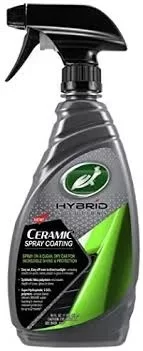

If you get that sorta fixed and still aren't totally happy you can also use Turtle Wax on the windshields after cleaning......works fantastic....plus you can use it on your rig too. (Make sure its this one)download.jpeg.webp
