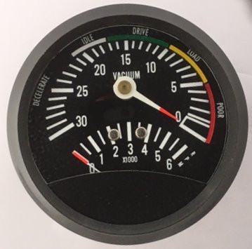

If you are running a carb, a vacuum gauge is nice to have. They can help show problems with the engine.
