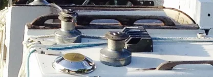

This is the same handrail at the companionway of my sailboat but I altered it to make it look better by rounding the filleted angle end of the commercially available teak handrail. They come in various lengths and numbers of loops.
