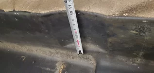

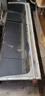

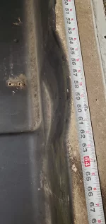

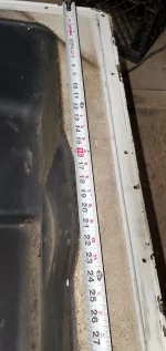

I had the same issue but I was lucky enough to find newer style wheels to swap in, hope these photos help. If you need anything else just let me know.
Those are some great pictures, it doesn’t look like they added much clearance, maybe 1-2”
Looks like they designed those to correct for unanticipated body sag, similar to the engine hatch cover :)
