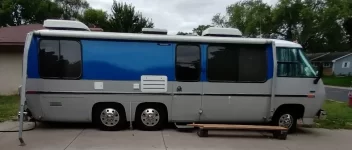

I used Sherwin Williams Genesis Fleet paint. It is kind of their Imron. It's tough as nails and I find it very difficult to make run or get a curtain. It's very chemical and abrasive resistant, we use it on our cement mixer. Definitely holds a shine and if you do get a run you can buffet out. Best part is it is a single stage and easy to match. I did find that the accelerator does change the color a little bit. So now I just stay away from the accelerator or retarders.

We had that paint put on the stretch in 2014. Sits outside on the west side of our house & it still looks like it was just painted.
