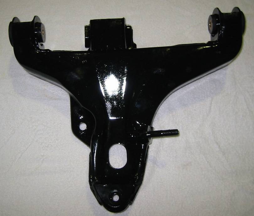

Looks like I have loose 5/16" bolts on the passenger side. I got about a turn and a half on the nut on the stud that sticks up vertically. Now I guess I'll drill out to 3/8" and look for some button head 3/8"-24 bolts.
Is there enough room to put a Nord-lock washer under the heads?
Be cautious with your drilling. According to Dr. Lenzi you can't make a round hole with a drill. And roundness matters with the fasteners for the lower ball joints. I drilled mine out and when I inspected them a few years later, the holes were more oval shaped than round.

Guys, thanks for the heads up. I will order the button heads and replace one at a time using red lock tight.

Tom and others. The best way, is to put the 3/8” button heads on and then smash the threads with a punch. I also would use threadlock They cant come loose then. If you do need to ever replace one again, you can grind off the button head same as you do with a rivet.

You should be aware that conventional lock washers work by taking a bite of both the fastener and the base parts. At Gr8, the nuts are usually too hard for the lock washer to dig into and so are problematic at best. If you clean both parts and add RED Loktite, that will increase the security quite a lot.

I used a Nord-lock washer, those things are fantastic. (with some red Loktite as well for good measure)
