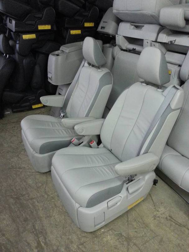

I put Honda Odyssey mid row seats in my SOB, and two pieces of 1.5 inch Unistrut installed laterally under the van seat and bolted down to the seat base put the seat right at the correct height.
Search the forum for “odyssey” for some ideas. Gmcrvparts.com sells a shoulder belt kit. Keep in mind that if you choose seats with integrated shoulder belts you’ll need to secure the seat to the coach frame because the existing pedestals aren’t strong enough. You don’t want to end up flying through the windshield still attached to the seat!
Jack, FYI, apparently Honda Odyssey minivans are a common conversion to handicap vans and the second row seats are a casualty of that conversion, which makes them fairly findable at a decent price. They also typically have armrests on both sides, are comfortable and a good size for our motorhomes. particularly if you want to retain the pivoting around to become extra living area seating. As Todd says, it takes very little tasteful butchery to adapt them to different bases. All this adds up to it being a common mod for our coaches. We did it about a decade ago and have been delighted with the seats ever since. They still look brand new.

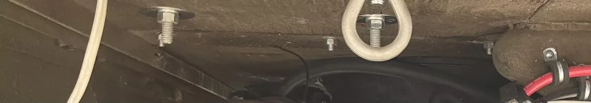

If you take a closer look at the bolts, the 4 seat bolts are larger than the (12) bolts that fasten the steel plate. The front (3) bolts in line are fastened through a chassis "strap/plate" that is welded to the chassis. That means that at least these bolts are actually fastened to the chassis. These (12) bolts fastened the original pedestal to the chassis.
I intend to investigate it further, but I believe that GM actually bolted the pedestals to the chassis and the plywood ws just a "spacer".
It is clear that the steel plate is bolted to a steel strap that is welded to the chassis.
In the above view, you can see the end of the front to back steel strap between the chassis and the side to side steel strap.
The original steel pedestal is a serious structural element that was directly bolted to the chassis. I just substituted a structural steel plate for the welded pedestal and used the original structural elements that GMC designed.
The (3) smaller bolts in the rear, running front to back are fastened to the steel plate and the strap that is welded to the chassis.
The rear line of (3) bolts is at the rear edge of the cockpit floor where there is a steel channel that appears to a steel cross channel welded to the chassis. The rear plate bolts are through this channel.
These bolts are the seat bolts. The 3 rear plate bolts appear to be through the channel behind the seats.
All of the fasteners are stainless steel, so corrosion is not a factor.
I was worried about the water damage to the plywood in this area. Instead of replacing the plywood with Coosa Board as Jim Bounds recommends, I treated all of the plywood with penetrating epoxy. I often do this when I am restoring a history building. I might do the thing to the underside of the plywood. The treated original plywood is now far stronger than it was when installed. It is now waterproof.
Your fears about the plywood floor are not justified.
Since the steel plate I installed is actually not depending on the plywood for structure. The new steel plate is actually fastened directly to the chassis as was GM's seat pedestal with (12) bolts.
As you can see from these blow ups, the plate bolts have fender washers and locking washers.
