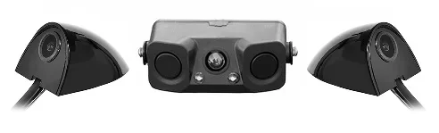

Over the weekend I installed turn-signal cameras to eliminate blind-spots when changing lanes or turning. I used a four-camera system I had, combined with a low-profile Android Auto screen with video input. So far, only two cameras have been mounted and wired; still looking for a good spot to mount the rear camera with obstruction/proximity warning.
I'm experimenting with a low-cost Android Auto/CarPlay unit from Amazon.
I have two rear-facing small streamlined cameras installed at the front wheel-wells. Because of how the cables are routed in the camera body, the camera has to be mounted in-front of the wheel (normally mounted behind the wheels where the doors open, but...). Yes, the camera housings are paintable and IP rated against water intrusion.
