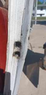

So my lower door hinge is messed up. The door hits the frame when closing. The frame reinforcements are broken and the bolt holes on the body are toatally screwed up.
Im going to find a welder to fix the aluminum, trying to decide if i should cut out a rectuangluar chunk and weld in a new piece or just clean up and have him fill in the wallowed out holes.
Any opinions?
You need to replace the section. You'll never get the door to shut correctly. Contact Dave Silva. I believe he has a complete door frame. He could cut the section out that you need.

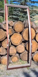

Guy on Classic 1973-1978 GMC Motorhome Parts is selling a door frame for $75:
Eric Schmidt
Stoepnsrdo28261ghilum9t32i1h3ha3t398ua54l6a1c1c104l62ah3ilh0 ·
I have a door frame that I cut from my parts coach. Anyone want it? $75+ shipping. I imagine shipping is spendy, and am leaving that research to the buyer. From 99217.
