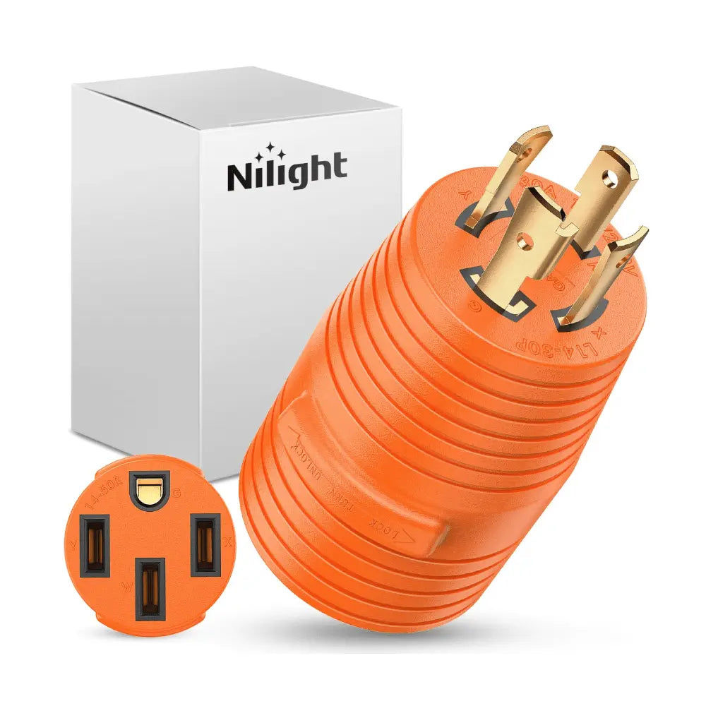

Many generators have a higher amperage twist lock receptacle in addition to the standard 15 or 20 amp receptacles like those found in your home.
A 30 or 50 amp twist lock is pretty common so one of these adapters should do the trick for you.
Be very aware that a 50 amp GMC has 2 separate legs of 120 volts, and is not the same as the 50 amp 240 volts that some larger generators put out. Do your homework before that inexpensive adapter becomes very costly.
