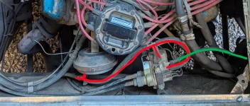

What is this? Do you have a picture?

I've attached the mystery vacuum diaphragm as well as a closer look at the cruise control vacuum where is it teed off from.
